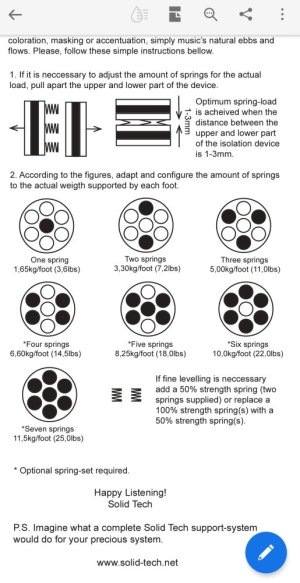

They are really worth their asking price. I and a lot of other forum members from hyderabad have used them and found them to be excellent. The biggest difference i found was a cleaning up of bass boom, which cleaned up the sound and made the mid range and upwards more clear. I would classify the gaia's as almost a speaker upgrade for a fraction of the cost. I then changed to townshend seismic speaker podiums, which are slightly better, but the cost difference is not worth it in my opinion. But my absolute favourite is my cheapest "Noob spring isolators". Once properly adjusted for the weight of the component to get the spring loading right, they drain vibration upto a claimed 5 hz. But they are limited to about 11.5 kgs . So anything under 46 kgs I prefer the cheap noob springs.
The difference between the noob springs and the other isolators is the exact spring loading that can be achieved with the noob springs, and not with the others. Below is a spring loading chart to use the optimum number of springs to get the loading just right .

Oh yes..I have rollerblocks under by DAC as well and transport as well. Am all for isolation but speakers on springs dont seem right as they store energy and you need something which dissipates.
