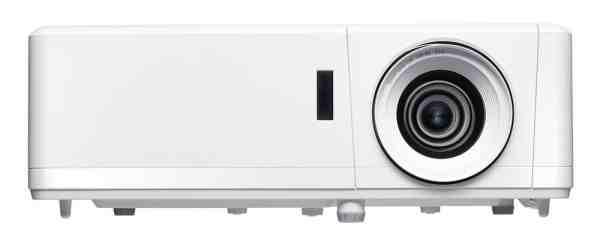

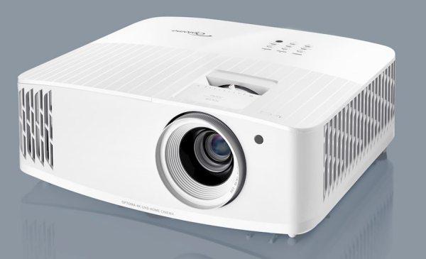

I had a quick look and saw some options which might be interesting and might fit in budget, please have a look. These may be commercial projectors and the usual applies. Please do your due diligence before buying if you decide to go with these.
