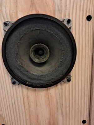

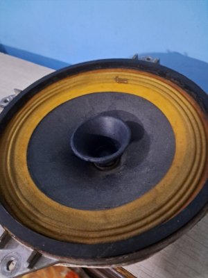

The title explains - Anyone owns a speaker ( full range or woofer) which has leather surrounds on them? Thecreason I am asking is my currentvRussian FR driver has a foam surround (PU type) which distegrates in 10 years time and will have to be replaced. My drivers are 6+ years old now and already shows signs of decay. I would require a replacement in another 6 months time. The reason for an early decay than the stipulated 10 years could be to unhealthy environment condition where I live - too much moisture and heat, too much sulfur in air causing the foam to de-colur from white to yellow.
I can purchase a pair of these surrounds for 60usd and replace them every 6 years, but that would mean a regular maintenance for these drivers. What I am alternatively considering is use artifical faux leather as surround material because of its strength and durability of use. But ivam completely unaware of how they may sound. Hencexam seeking opinion from FMs to share their experience.
