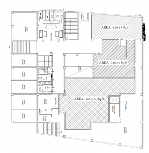

I am upgrading my audio set up in my bar. Got a few suggestions from local AV guys for the below. Would be great if any of you could throw in your 2C.
Objectives: Get really good quality of sound (rather than more noise) compared to the present set up which is basically local satellite speakers and sub. We will be playing mostly deep house music. The system will be playing almost continuously for 12 hours everyday.
Proposed Budget: Rs.11,20,000
Speakers x 12: 420000
Amp for above: 300000
Sub woofer 4 nos: 300000
Cables and accessories: 50000
Installation & Commissioning: 50000
Proposed Speakers by local Vendor: Turbosound NuQ102 x 2 in 736.31 sqft area
Turbossound: NuQ82 x 4 in 629.63 sqft area
Tannoy VX6 Coaxial x 6 in 1382.47 sqft area
Proposed Amps:
Labgruppen PDX 3000 for the Turbosounds
Labgruppen CA 2402 for the Tannoys
Shaded 3 portions is the Bar Area
Bar Area Total: 2747 sqft
629.63 sqft: Long bar counter + 4 tables of 4 chairs each
736.31 sqft: Lounge type seating
1382.47 sqft: Long bar counter + 11 tables 4 chairs each
Bar Layout: File Attached
Putting all the details in here for however it can help in suggestions from you all. Thank you.

Is there Dance floor in any of these areas?

No dance floor.
The system proposal for two of the smaller areas seems like the system plan is for a dance floor.. the audio distribution isn't planned properly then one part would get more SPL over the other.
Another question - at what volume will you normally play? Will it be loud?
The 6" Coaxial might not be powerful enough for such as a huge space if high SPL is needed.
There is a glass partition wall with door seperating the 1000 plus area from the above 2 smaller areas. Volume is intended at pub levels. There is no dance floor. I can check the actual desired decibel level and revert today.

You are thinking right..
Distribution and correct angling is critical..
And for those volume levels and duration I really doubt the 6" Coaxials will be sufficient.. coz, if pumped you will risk blowing all the 6 speakers together..
