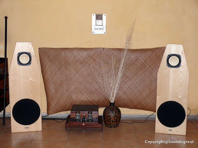

The First Look :

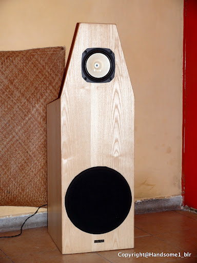

The Speakers look stunning with the cedar clad suit,The 2 drivers in the speaker are individually covered with its own grill as opposed to usual full cover for both (or more drivers)

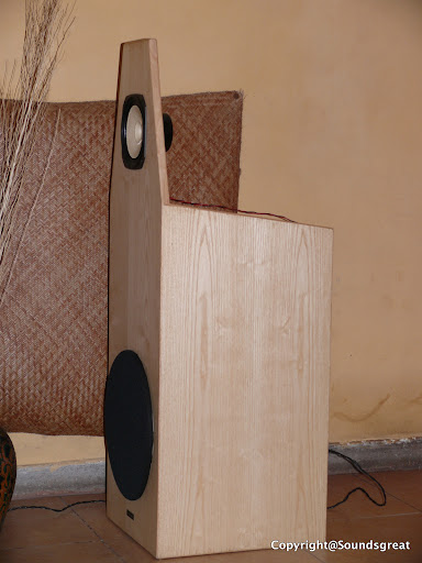

The Full Range driver is used in boxless design (Open Baffle ) and the bass driver is housed a port tuned box with fairly large port (2+ inch)
The Box (for the Bass Driver) is big as its required but doesnt look imposing due to cleaver design and mating with the open baffle !! the speaker looks small from the front and similar from the sides as well !
At the back theres only one pair speaker terminals ( no Bi-Wiring option).

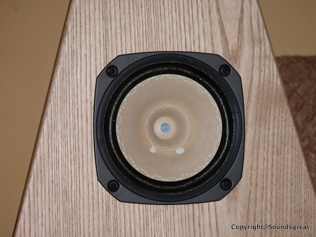

The Speaker is blessed with a 6 Fostex (FE 167E) driver which is in open baffle (Box Less ) design,the cone of the driver is treated with some additional stuff( The white dots on the cone) to make the necessary changes to drivers response to suit the open baffle design,This is said to have numerous advantages over the regular boxed designs such as standing waves,internal box resonance,port noise etc... !! This driver is a typical Fostex with usual bells and whistles such as the banana pulp cone and dual cone sort of centre cap (Dust cap),the driver is capable of going as low as 50Hz approx which is very very good for a fullrange driver !

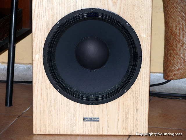

The Low frequency duty is handled by a 12" Eminence (BETA-12A-2) in a regular ported box,The port is tuned to approx 40Hz !! the box was designed with home audio in mind so the size is regular as opposed to very big for the same driver in pro audio use !! The crossover used for this driver is a first order 6dB crossed at 300Hz,so this driver essentially handles all the stuff from 40 to 300Hz while the rest is sent to the Fostex.

The Speaker is designed very well with the rounded edges and such,the Speaker box looks very good with the fullrange sitting on top with no box and the woofer at the bottom in a port tuned box,the overall symmetry of the box is well balanced ! the box part of the cabinet although is bit big ( in conventional home audio sense) is cleverly camouflaged with the use of light coloured cedar veneer for the final finish which takes away the bulky looks and gives it a smallish and compact feel ! on the top, the edges are tapered and sort of forms a trapezoid ! The port of the woofer box is located at the back and is situated just above the bottom surface of the box,above the port is the speaker terminal ! overall the back is as neat and as good looking as the front !

The speakers were placed a bit close to the wall and were approx 6+ feet apart,there was a jute mat between the speakers (although Mr.Viren says its purely for the looks I think it does have some quality to add to the overall sound )

I have a question the top driver doesn't have any enclosure does it expose it to natural wear and tear over time. Or the drivers are naturally resistant against that.
The answer to your question is bit tough to answer,however this is what I will say, If the speaker is exposed to excessive dust,humidity and temp etc most certainly it will fail in some time (so does the one with the box,but perhaps not as fast as this ) and these driver have no special thing to make them resistive against the above mentioned conditions ! also if there are rats or roaches problems one's room where this is to be played then better ask Mr.Viren to provide a net or covering thing to make it bit more resistant !
