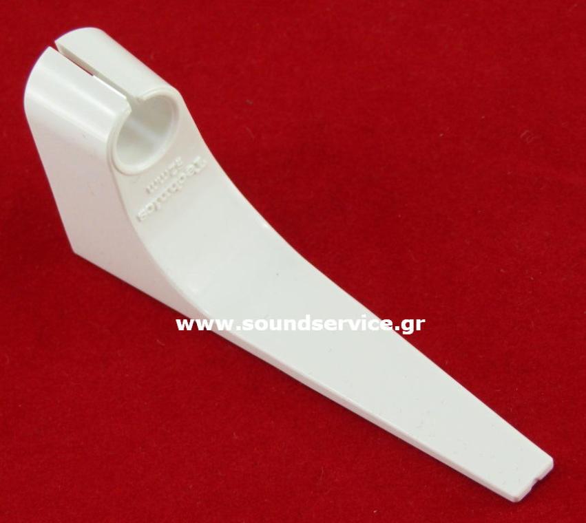

The effective length (overhang) of your Sherwood PM 9805 is :10mm. If you don't have the original overhang gauge for this turntable, please try to do this: Get the Overhang Gauge of the Technics turntable which is used in most of the 'S' shaped Technics arms with effective length of 15mm. it's easily available on eBay for $10. With that gauge, mark the thinnest line below 5mm of the overhang tip of the Technics Gauge. So ,that is the overhang point (10mm) of your Sherwood TT. Firstly, please set the cart by using this gauge, then you can verify with the protractor also. Hope this would help.
Problem with this tt is" It's pivot to spindle distance is 205 mm, arm length 180" I do have Technics overhang gauge. I have tried what you said. I have already mentioned in one my previous post that if the cartridge could have been moved back by a few mm then I could have aligned it properly without twisting. I have many headshells starting from universal to technics none of them have such slots where the cartridge can be moved back further to get the desired effect hence I had to twist it. It is worth mentioning here that none of the specifications mentioned in the manual of Sherwood is correct.
