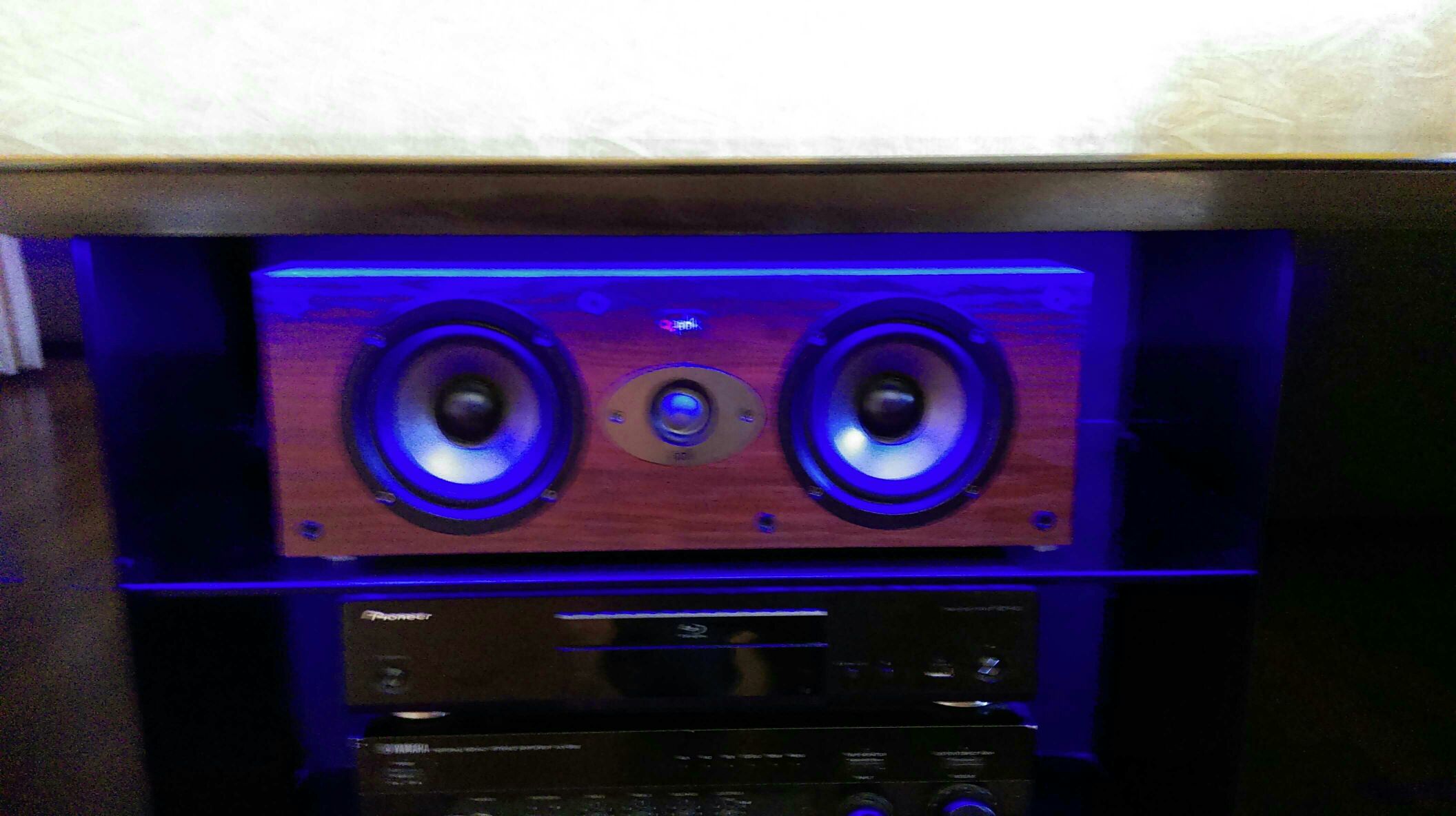

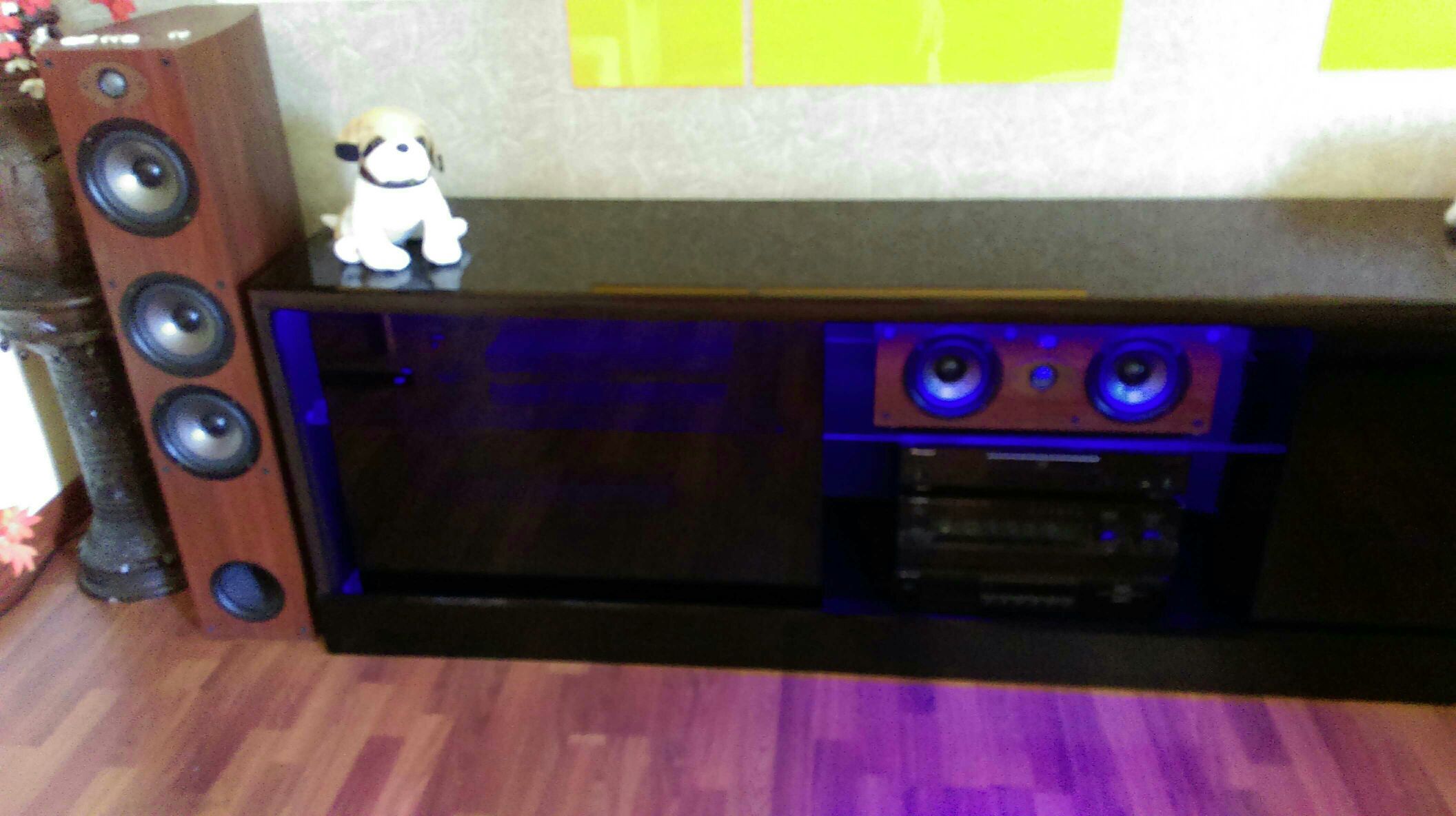

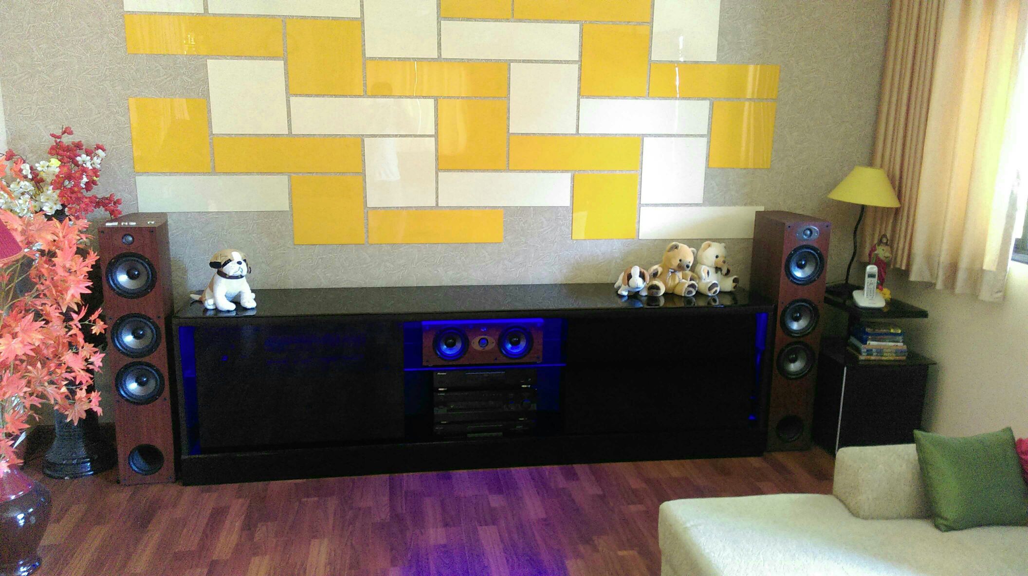

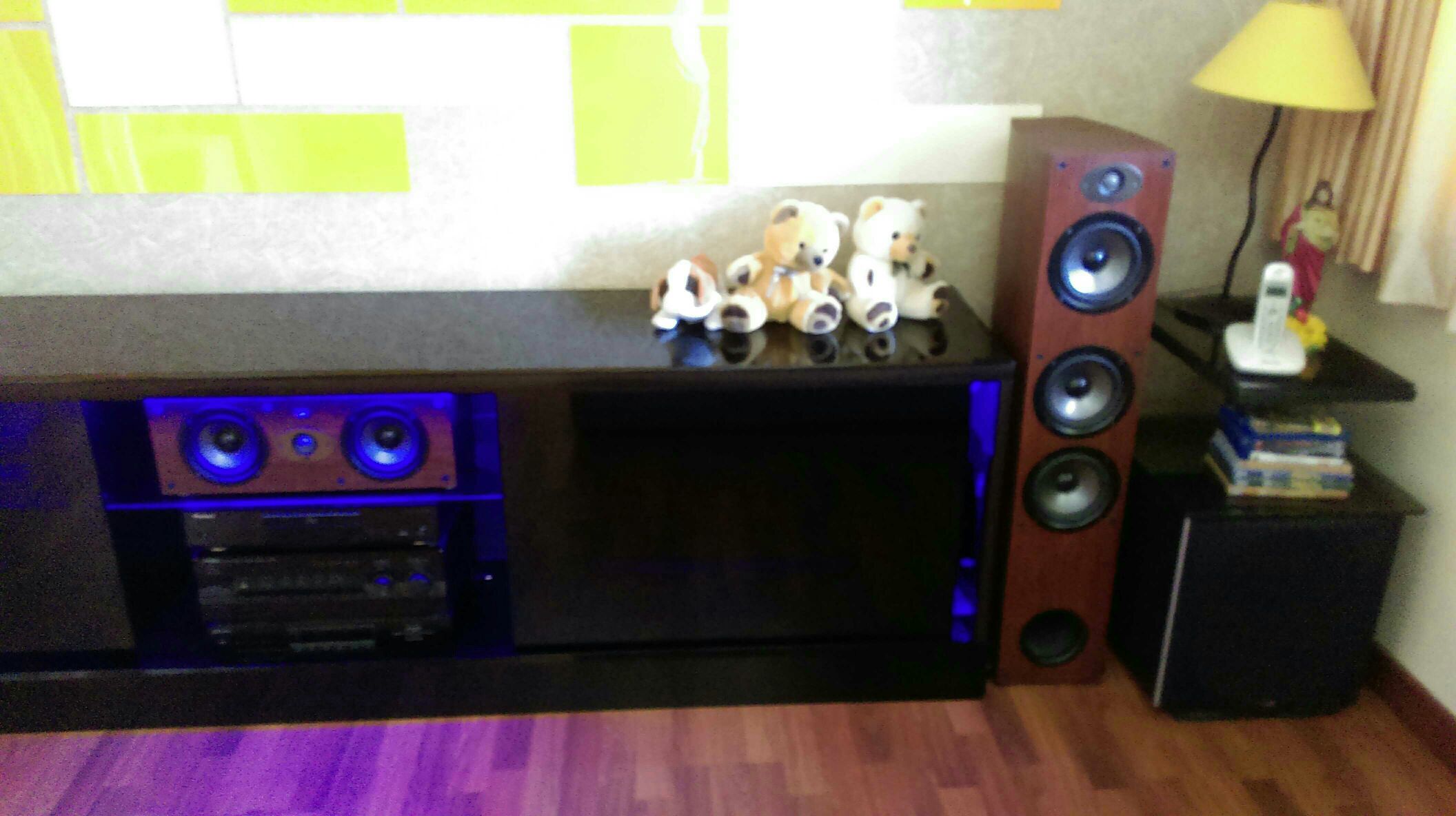

The abv pic are of my centre speaker kept in a cabinet.......

Not an ideal situation. Neither for Ported nor otherwise. Try keeping the center on the shelf while watching movies and for casual listening you can place it inside.
Also, keep in mind the Polk are inherently bright sounding, so seem to sound thinner than any other warmer sounding speaker. Realized this after I switched from Polk TSi200 to Elac B6.

I cannot keep the centre on the shelf as it will block my projector screen behind which remotely slides down for watching movies. Should I go for change. I mean replace the centre...
