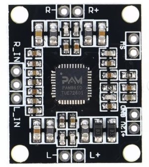

Hello,
I have a PAM8610 Dual channel amplifier.
Is there a way I can combine dual channels outputs to one and drive one speaker with more power (input also need to be one channel)?
Basically convert PAM8610 Dual channel amplifier to mono amplifier.
If some one could please explain how the wiring should be on input and output.
Attaching the board picture.
It is a very complicated thing to do even if the board supports it. We don't even know whether the board supports it or not. So I would suggest not to take the risk.
Yes, pam 8610 it is already bridged.

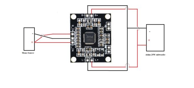

Can I do something like below?
