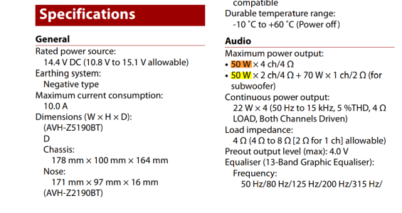

Thanks. About power supply 12V is understood from the specs. What should be the Amp if I plan to have a typical pioneer or JBL component speakers combo for around 6000.
Rating in speaker specs say 50w nominal per channel @ 4 ohms. Is it for midbass and tweeter put together. That's not very clear

Higher the current , more volume , the more speakers you can connect -2 or 4 and a Sub. Say 5A for 2 spk. 10A for all spk driven . In theory you can use 12V / 1000A too, but cant use 16V / 1A. Voltage should be fixed , current -whatever is required + headroom, so 15A
don't worry about mid/ tweeters, anyways they require less power and total impedance of a component spk stays 4Ohms. Trust me, you would never be listening at 50W X 2, nor the car stereo will be able to put out that much power without compromising on distortion. Just buy budget spk 2K-3K max but a box with a bigger volume as space permits than normal shoebox sized enclosures using 15mm MDF

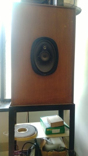

I had built old school style speakers 27"H x 18"Wx 11"D using Kenwood KFC7171 7x10" 20y ago, still rockin'. Kept it on a standard MS heavy stand, tweeter placement at 41" from ground. Music/ HT , everything sounds good without subs. Damping material used are coir sheets bought from mattress store.
