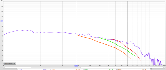

Dear Fm's
I am trying to calibrate using rew and noticing some irregularities with crossover measurements. The Blue graph is subwoofer measurements after calibration. Now if I turn off the main speakers(Left&Right) and run sweeps for mains changing crossovers to 40,60,80,100,120,250 the sub should roll off at each frequencies as i have highlighted. Instead I get the same blue graph for all the crossover values. This means the subwoofer is not rolling off at the cross over value. WHat can be the problem here? Some software bug with AVR?
