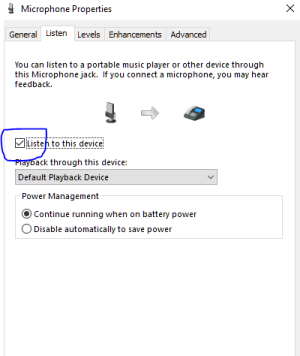

Though I haven't tried, but try getting a 3.5 mm to 3.5 mm stereo cable and connect monitor's headphone out to MIC in on the computer and that way the audio should be routed to DAC via USB. Keep in mind though if this works, it just for the sake of convenience because you will not be benefitting from the DAC's quality conversion because your digital would have already got converted by Google device.
Fortunately, I had all the necessary hardware to test this, I tried and it worked. Just that after you connect the cable, you will have to enable this setting.
