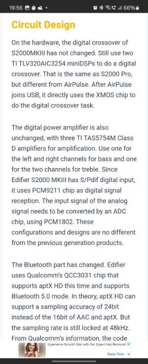

won't the Edifier S2000mkiii be limited by its internal DAC even when fed through its analog/ line inputs since it has to go through an A to D conversion first and then back again from digital to analog using its own internal DAC chip or am i missing something?

You are right. The speaker does DSP and and analog inputs are selected from the ADC/DAC PCM1802 chip
That is, no DAC will make a difference due to the internal circuitry of the Edifier S2000MKIII or even in the sound signature?
there will be a slight change in the sound signature because the initial D to A conversion by an external DAC will leave an imprint of its tonality on the analog signal coming into the S2000 mkiii - before being converted to digital again. However, you won't get better resolution and other improvements that come with an external more competent DAC.
