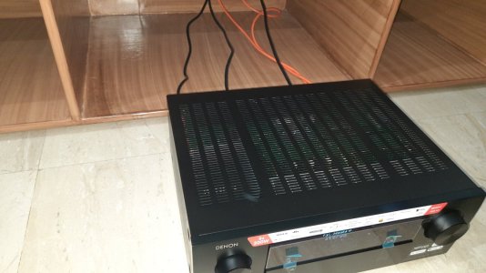

Plug socket earth issue!!This is weird when i put on floor as u can see there is no humming and if i put back inside tv unit there is humming can u help? WtfView attachment 86257

I guess some electrical device close to the rack is emitting some emf/rf which the transformer is picking up.This is weird when i put on floor as u can see there is no humming and if i put back inside tv unit there is humming can u help? WtfView attachment 86257
I have panasonic 4k player to the left side inside tv unit some 4k disks inside plastic box on right side and tv on top of tv unit thats itI guess some electrical device close to the rack is emitting some emf/rf which the transformer is picking up.

I removed every plug but did not help. But i put bluray player out it was not touching tv unit wood there is i guess no hum . Can you tell whats is happeningDisconnect everything including the tv from the power source and power up the Avr alone. See if you are still getting the noise
Do you have any voltage stabilizer nearby ?I removed every plug but did not help. But i put bluray player out it was not touching tv unit wood there is i guess no hum . Can you tell whats is happening
