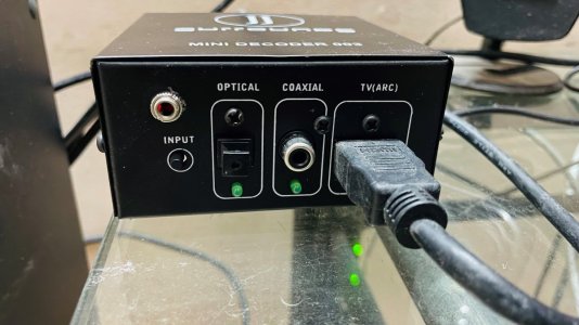

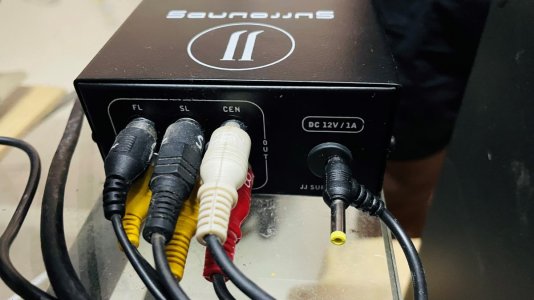

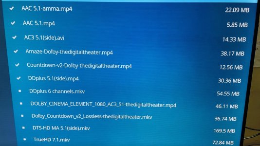

I am assuming you have double checked that it's actually decoding 6 discreet channels instead of simulating them. Also if possible can you post some pictures of the back of the unit? The website doesn't seem to have any

Yes, I have these test files with most of the audio formats, And all of them worked correctly by sending sound to correct channel.
Attached pictures.
