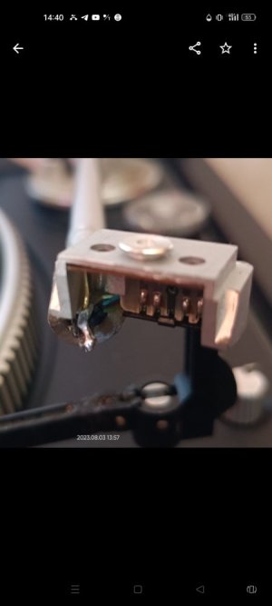

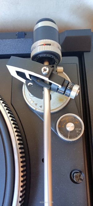

Hello,
I have the player in the subject. I have the situation in the pictures attached.
What do I need to complete this setup?
I was advised to ask in a forum and to refer to dualfred. I'm not that expert on this record player

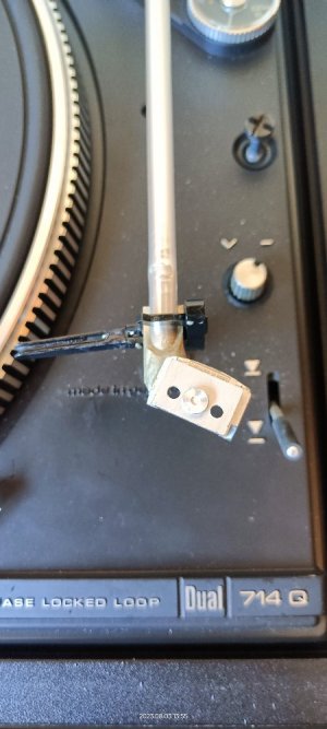

one of the better dual direct drive turntables from the late 1970s, you will need a proprietary dual head shell and cartridge for the tonearm on this turntable. If I recollect correctly, some Duals had longer head shells which accommodated standard 1/2 inch mount cartridges. You'll have to search around for these.
Hello Dear Friend, Congrats for Dual possession. If u wish to buy headshell you shall need to purchase both headshell & it's holder (broken part). Alternatively you can bolt your cartridge on a light weight carbon fibre and bolt that combo (carbon holder+cartridge) to your broken headshell to get in working condition & shall be cheap, shall require minimal investment to get it working.
thanks for info
so if I understand I need to change also thee holder in picture 3 I posted? as well as the headshell and the cartridddgee?
where can I get all this online?
