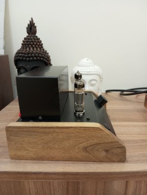

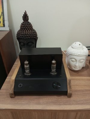

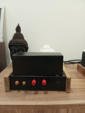

Hello Friends,
I have listened some branded integrated amplifiers and power amplifiers for the past few years. I wish to hear some more high end amplifiers but my budget does not permit me to afford. In this situation i got introduced a nice person through this forum Mr.Vijay Prabhu (@tnvijay) to whom i discuss about my interest in hifi music and my limitation in buying high end audio peripherals. He told me that he will make me a valve amplifier made of a pair of ECL82 valves which is affordable for me. I have waited for a couple of months and then he gave me this tiny little Giant ( I have attached the photo) which consumes only 12v 5 amps power supply and the output of this amplifier is only 1 watt but the sound is amazing. I am very much satisfied with this amplifier. I am using ahuja SK-12FR X full range 12 inch speakers for this amplifier. It is driving the 12 inch speakers well and the sound quality is remarkable. Thanks to Mr.Vijay Prabhu (@tnvijay) and hifi vision forum which is a good platform for many audiophile members who can learn many information about audio. I am also very thankful to the forum members @Kannan, @reubensm, @Vimal M who assisted me very much in exploring new possibilites in audio.

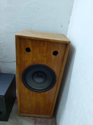

Very nice to see an affordable tube amp. Can you share some pictures of your speakers as well?

Very interesting speaker. Can you share some more information on them?

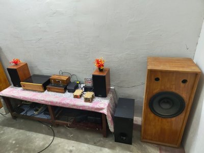

Thank you friends. The speaker I am using us Ahuja 12 inch sk 12- frx. Which cost me around 3.5k for pair. The wooden box is custom made which costs around 5k.

Thankyou sir for your kind words.. Just a small information - we get around 1.8 to 2 watts, and if you have high efficiency drivers, This can be surprisingly loud in a average listening room...
