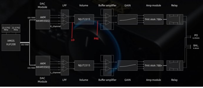

One more query. Following is the diagram from fiio website on K7. Have I marked the LO and PRE correctly there? Basically both are before amplifier but LO is before volume control
