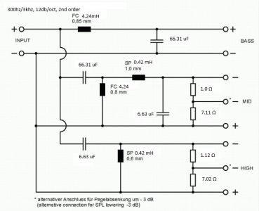

From long ago, I was much interested in building 3 way speaker DIY project but after doing some research and gathering some knowledge, I found it is hard to build a 3 way DIY design especially the testing part needs more knowledge but I found a project in this forum which was build by arunvenkats and along with the help of local peerless dealer in chennai, I decided to go with arunvenkats's plan https://www.hifivision.com/threads/3-way-sealed-speaker.97885/
I have done slight modification on the driver selection and crossover components, basically I'm not a EEE guy but gathered some knowledge on calculating crossover components, and requires help from all of you in each stage until I complete this project.
Here is my driver selection

Here is the modified crossover design:
