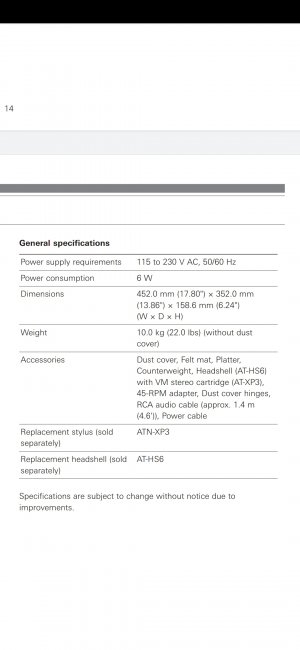

The specs online says that it's power consumption is only 6W, why would it require 7 or 10A fuse?
