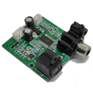

Grab this before it goes out of stock. This is all you need.
