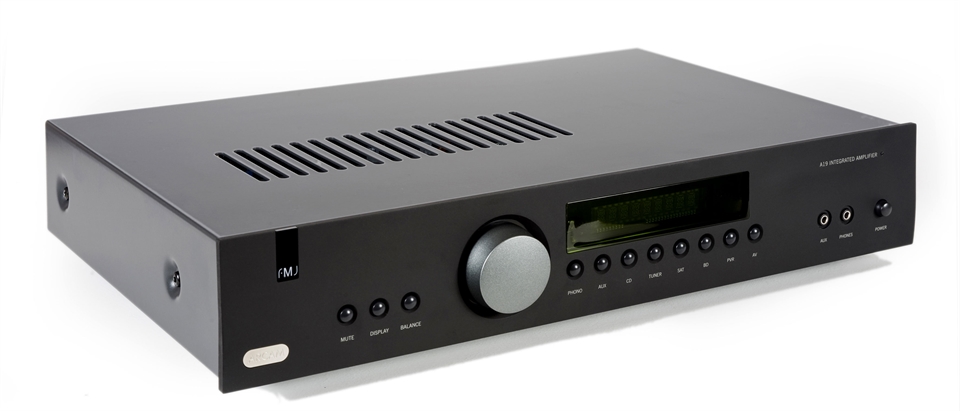

I have never connected and heard a high end headphone to the audio output in front of my Arcafmj A19 integrated amplifier.
My question is "will I get an audiophile grade audio output from a high quality headphone connected to the front jack of my fmj A19?"
If so, which headphone will you recommend?
Thank you all in advance..
The headphone output of most IA's are decent enough to drive most of the audiophile headphones. What is your budget , preferred signature and also are you fine with open backs (which would leak sound ) ?

Pls check check for specs of the amp section in the manual. They would mention the impedance of headphones to be used. If the max is under 300 Ohms avoid buying the Sennheiser hd600/650. The HD660’s could be a better bet in this case.

I dont want to sound pessimistic, but sometimes the head phone output on an amp is a box ticking exercise and might not warrant an investment in the price bracket you are considering. Many a times, the preamp output is directly routed to the headphone section with no dedicated amplifier section, which makes it difficult to drive a lot of head phones. I had a parasound halo integrated long back with a texas amplification chip for the headphones and it was just about decent with some denon cans I was using then. My present preamp has a better dedicated headphone out than the parasound, but i dont know if it is good enough to warrant spending on a headphone. I probably have to compare with a dedicated headphone amp to make out.
I understand it is not easy to find fellow headphone users in Trivandrum to try out some cans before you buy. But maybe you can mail arcam or search more on the subject before you spend the money. Just my 2 cents...but dont want to ruin your enthusiasm to try. All the best.

Just recently I got myself a HD650 as I wanted to make use of the headphone output of my Marantz PM8006 and I am less than inspired.
The sounds falls way short of HD650 fame.
I later learnt that PM8006 doesnt have a separate headphone circuitry and it just steps down the speaker output.
However, going by this review your amp is a fairly competent one in this regard.
