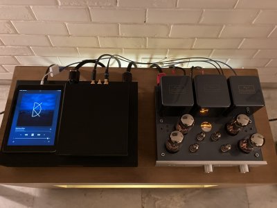

I have set my phone to 24/48.
CCK -> DAC -> Headphone amp/system

In my setup above, is there any way to remotely control the iPad? Perhaps, with some app on my iPhone? Skipping tracks while browsing is a major pita.
