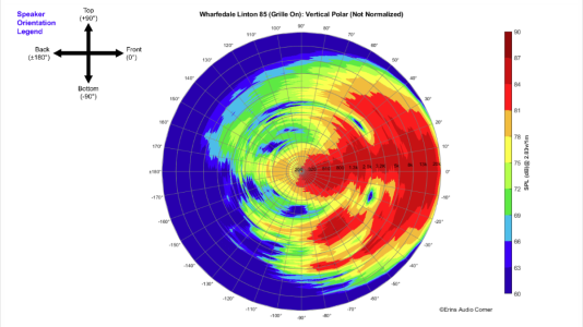

How far do you sit from the speakers? The vertical dispersion till 20deg is good for the speaker looking at online tests, so as long as your ear height is within that 20deg, no need to bother with increasing the speaker height

Stay at tweeter level. If you go even 10° above or below the tweeter level, the timbre of the speaker is noticeably different and worse
I would recommend to raise the height of the stands to get the tweeter either at ear level, or above ear level but within that 20 degrees of vertical dispersion if raising above ear level. When I played around with my speakers height, I preferred having the tweeters above ear height, with the speaker slightly slanted forward. The line joining the ear to the tweeter extended behind the speaker till it meets the rear wall, is where the sound will be perceived to be emitting from. Having the tweeters below ear height will reduce the height of the sound stage.
I listen with my ears in level with the mid range drivers, and I prefer the sense of height this brings. Though this is a very front row presentation, and others might not like it. So you can consider placing something below the stands, like concrete blocks or marble slabs etc. And at the same time, you can try adding some sorbothane pucks between these slabs to isolate the speakers further. There is no one correct way, and one has to experiment with number of pucks and types till he gets his preferred sound.

This discussion is very academic and there will be as many opinions as there are posts. No two speakers are the same because their characteristics are different (so what works for one with their speakers [or for you with other speakers] may/will not work for you with the Lintons) and similarly, no two sets of ears are the same as your preference on sonic presentation will be different from others.
FWIW, I suggest that you listen to them on their stands with you crouched (or whatever) so that the tweeter is at ear level and alternatively at your listening height. Choose your poison appropriately and then decide what works for you with the Lintons.
i see where you're getting at but it may not be true for inverted tweeter designs (Mid above tweeter). I've found them to be able to project as good a sense of height as traditional arrangements or better when the tweeter is below the ear - the surest not so secret sauce is to have your ears between the tweeter and mids no matter the arrangement of the drivers so that you don't hear too much or too little of the tweeter or midwoofer. :)
