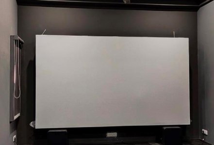

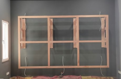

How are you planning speaker placement? Do you already have the speakers?
Would you like to have the front LCR hidden behind the screen?
That is what I have done in my dedicated room with bookshelf fronts (Dali Zensor 3).
For that you need an acoustically transparent material mounted on a wood or metal frame.
Spandex from an Indian source or Carl's from USA.
What is your planned screen size?
1. 120”
2. Speakers are already placed infront of the screen, that’s the reason I am looking for fixed frame.
