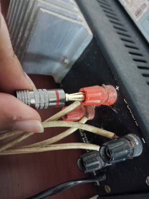

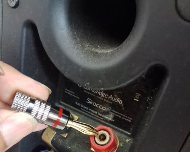

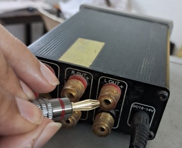

Dear Sachin,
Can you pls suggest me the correct type and size of banana connector for my amplifiers and speaker?
Bought 4mm ones from Amazon ..but they could not be inserted...see the pics
Returning the items for the 2nd time 😒
Amplifiers-Norge 2060 & Topping tp 20
Speaker-Cambridge Audio S30
Dear Sachin,
Thanks in advanceView attachment 86631View attachment 86632View attachment 86633

Don't see any reason why it does not fit both... the amp and speaker.
It may be tight initially and will require some force. Just hold the amp and push in a little till the springs compress.

You have to apply force and push it. These connectors are correct.

The banana insert point at the back of norge is small and I am facing the same problem but as my amp is at one constant place the plugs do not get disturbed. I an using a MX plug which is similar to the one that is shown in the picture. Check at Hifimart site there is one model in pink and black coluur that has different locking mechanism. I think it is sold by hifimart on behalf of sound foundation. If you can get a similar model it will fit properly. I is called "Spring fit grip".
Yes. There are two kinds of banana plugs - ones that are springy which you just press in and the other where you turn a screw to tighten them. I’ve always found the latter gets loose after a while, disturbing the connection. But the springy ones remain snug.
