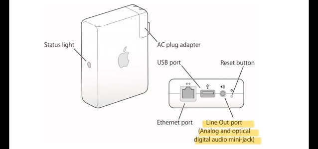

The 3.5 mm jack out from AirPort Express is actually a dual port. It will transmit analog signal if you use a 3.5 mm to RCA cable into your AVR. But it is also an optical digital port and if you connect the AirPort Express with optical cable to your AVR, the digital signal will be transmitted and the AVR’s DAC will be used.
Thta
That doesn't sound right to me
