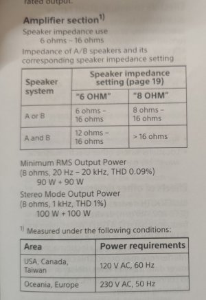

Friend, the manual of amp shows that the RMS value is 90 W per channel. Max power is 100 W per channel.
Could you please confirm once again by referring to the screenshot of manual I have attached, if I can connect DBR62? Sorry, I am new to all this so unable to figure out by myself.

The RMS figures are for 8 ohms. Do not get confused by that. This amp will drive your speakers if you use one speaker out section, say 'A'. If u are not confident call some technical friend to ur home. Regarding sub connection let someone else answer from this forum who is using similar subwoofer. Check some videos on you tube, you will get answer to most of ur doubts. If they have made amp and given u an owner's manual they must have described ways of connectivity. I feel the line 4 in and out at the back is for powered subwoofer but i am not so sure. Check in manual.
This video will clear your fundamentals. He has shown connection with integrated amps. Although it is not relevant with your receiver. I think the best setting for you will be to take main speaker out from "A", and subwoofer out from "B" just like shown in the other videos I have posted previously.
