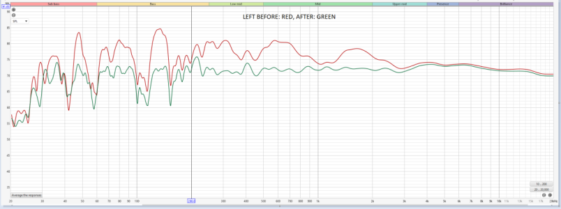

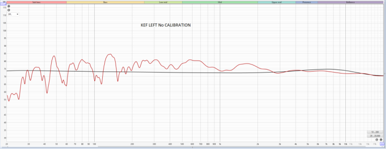

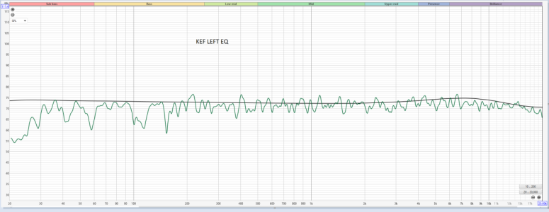

KEF Left Before and After EQ superimposed:

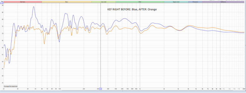

KEF Right before EQ and after EQ:- sharing one chart

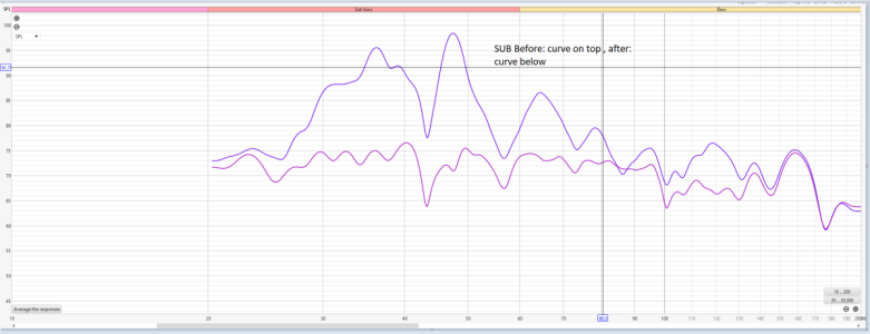

Subwoofer before and after EQ:

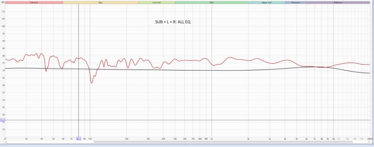

Combined effect of final test signal with LEFT+ RIGHT +SUB:
In my opinion the trouble was more below 100 hz given the spikes in the sub.
