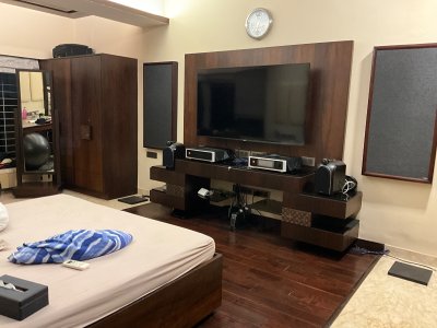

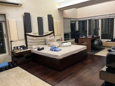

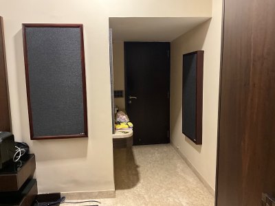

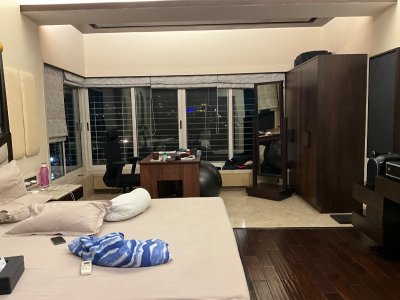

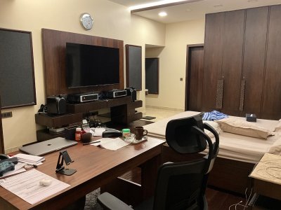

1. Budget?
2. Room size?
My budget is Rs 1L - 1.5L
My room is rectangular, with approximate dimensions equalling 16ft x 10ft x 12ft. There’s a short passage of 5ft x 3ft x 7.5ft leading into the room.
The speakers and subwoofers are placed along the long wall of the room and I’ve got some acoustic panels on the opposite wall.
1. MJ acoustics Pro 80
2. SF Gravis 2
3. Kef kc62
4. svs 3000 micro
4. Rel classic 98
You can try auditioning these if possible. My preference are the MJ and SF as I have heard them on multiple occassions and always found both of them excellent for music. Good luck with your hunt and selection
