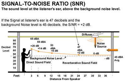

An example of room SNR here.
The actual calculation of SNR ratio is

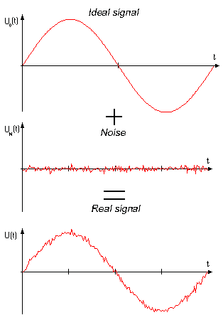

Here is a simplified way of looking at noise and how it affects your sound. From the figure below you will see that you may not even realize that there is noise in your system until someone shows you or you reduce/eliminate the noise in your setup (Power conditioning, cables, etc.)

I didn't read all (Later, I have to go out... :o) but Nikhil, I'd call the kind of noise you illustrate distortion. But I'd agree I suppose that that is a kind of noise.

It's just a signal notation as a function of time.
Thanx but I don't think the noise floor would alter the signal the way it was shown in the graph. If noise some how changes the fundamental frequency like shown in the graph then I don't think audio compression such as MP3 would work. *But if it is then we may have an explanation why we hear lower NF.*

I didn't read all (Later, I have to go out... :o) but Nikhil, I'd call the kind of noise you illustrate distortion. But I'd agree I suppose that that is a kind of noise.*

IT is an interesting graph but I read the website from which the graph was extracted and they clearly used that to describe noise (SNR).*
