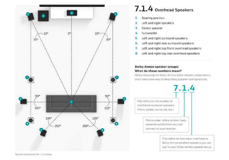

Ok.. 7 channels are standard layout.. 4 refers to the height channels..
6013 is a 9.2 AVR. which can power only 9 channels.. So 7 standard channels + 2 heights it can do out-of the box.. That makes it 7.1.2.. To make it 7.1.4 you need an additional 2 channel power amplifier..
A picture for 7.1.4 layout
