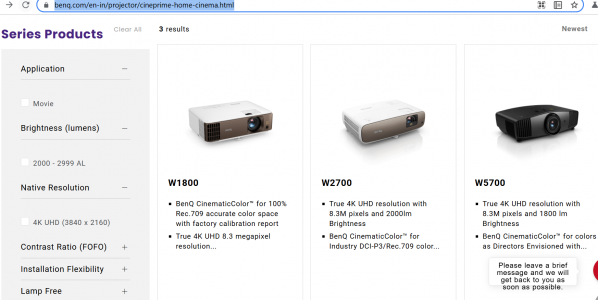

I see! Then I wonder why BenQ has listed it as native 4k in their website (I am referring to https://www.benq.com/en-in/projector/cineprime-home-cinema.html).
In their three CinePrime series projectors, they have listed W2700 as native 4K, whereas W1800 and W5700 are not native 4K. Any idea how they can make such a claim? Or is it just a mistake in their website?
I didn't find "native 4k" mentioned there, but I did see "True 4k" which is NOT the same as native 4k
They are not calling it "Native 4K" in their website. Instead they have invented their own term "True 4k". The difference being - True 4k is actually simulation of 4k by fractionally shifting 1920 X 1080 panel (Which is its actual native resolution - HD only). Native 4K are way more expensive.
Epson Tw9400 does the same trick, the difference being they are only able to simulate upto 2K resolution using their native HD panels.
It's true 4K projector not native 4K. Where they claimed?

I am referring to the page https://www.benq.com/en-in/projector/cineprime-home-cinema.html. This lists their CinePrime series projectors (W1800, W2700, and W5700) - the first screenshot below.

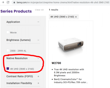

Now, if I click on the 4K checkbox under native resolution, the link changes to https://www.benq.com/en-in/projector/cineprime-home-cinema.html?native-resolution=4k-uhd-3840-2160. And the list now shows only W2700, as shown in the second screenshot below.
It's look like just mistake in the website.

There is one place in their website's india section, where they have given the impression that W2700 is native 4K (see the link my message above). Now, I dont know if it is just to mislead people.
