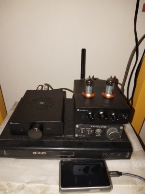

Please share your thoughts on Q Acoustics 3010i Bookshelf Speakers and how it will work with fosi v3 amp(I use only given 32v 5a power adapter)+ fosi p3 preamp(upgraded with 6k4 bigger 5654 series tubes)+ fx audio dac x6+ hiby R3 II DAP As USB AUDIO SOURCE. I am not going buy any upgrade power adapter(48v/53v) further for more power as it gets more hot by it, So please share your thoughts on it(i.e. power adapter) as well.

Your Pioneer is actually a little hard to drive. So, if your fosi could drive pioneers, it can drive qacoustics as well. I am not sure if you will feel the upgrade though as pioneers are really good speakers.

There's going to be a difference but not really much of an upgrade - 3010i's are VFM entry level speakers and perform as such. In order to really "feel" the upgrade, i would suggest going with a 6.5 inch bookshelf - something like the Mission QX-2, or at the very least, the Wharfedale Diamond 12.1.
I use the upgraded 48v/5A supply and thermals are well under check - warm to the touch but no overheating whatsoever.
As to whether you'd require the 48v/5A PSU, it all depends upon how loud you pump your music and the sensitivity of your speakers.
If you want to listen at above 80db with speakers which are less than 85db sensitivity, i'd suggest the 48v supply as my 32V supply would run out of steam with my Dynaudio Excite X14 which are 84db sensitivity.
