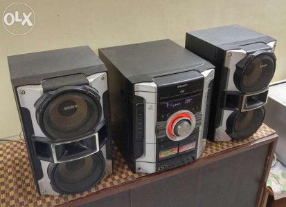

Hi...Thanks for the Reply. I use very old SONY passive Speakers that cam along with a DVD player
Since I watch a lot of movies I was under the impression that the Centre Channel was what I should start with and then upgrade me left and right.
Let me check OLX as well

Speakers are speakers as long as there are no impedance issues or watts handling. You can connect the same carefully and try at low volumes and see if the AVR is overheating fast etc.
If the Sony speakers are working fine then go for the center then the sub and later perhaps update the Left + Right and surrounds based on available budget

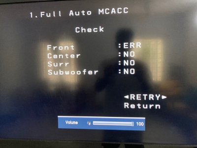

3. I have lost the setup mic that comes with the Pioneer receiver. When I try to calibrate with some other mic I am getting sound on and off from the front right speaker and then an error as shown in the image. Is there a special mic I need to calibrate it?
