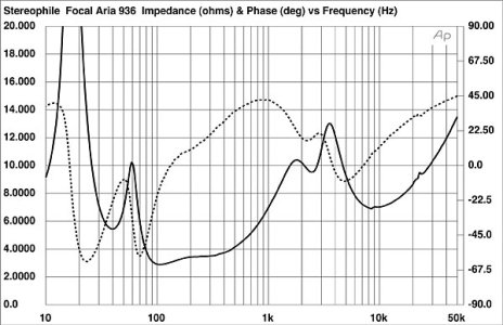

I am currently running the following 5.1.2 setup in a 16x16x10 dedicated home theatre room mostly used for 2 channel listening: -
AVR -Marantz Cinema 40 (Rated at 125 watts per channel - 2ch driven at 8ohms)
Subwoofer - SVS SB 1000 PRO X2
LR - Focal Aria 926 (91db sensitivity/8ohm nominal impedance/2.9 ohm minimum impedance)
Center - Focal Aria CC900
Surrounds - Focal Aria SR900
Mid Heights - Focal ICW 300/500
My main listening position is 13ft away from the speaker and I like listening to loud music. I am wondering if I should get a power amp for the front LR speakers to improve my 2 channel listening experience? Would it give a tangible improvement other than loudness? If yes, which one should I go for?
