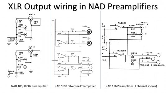

Being a long-term NAD user, I was also sold on the idea about NAD presmps with XLRs being superior to straight edge ones with RCAs. I had the NAD 106 preamplifier purely because of the XLR output feature and thought I had something super-special until I opened up the box one day and found out that it was all essentially a few resistors and an XLR socket for each channel. I revised my mindset shedding baggage and ended up finding a much better preamplifier (without XLRs incidentally), the NAD C160. The NAD 106 is long gone and I could not have been happier with the NAD C160.
The schematics always reveal the truth :)
