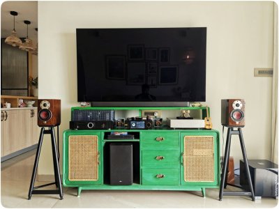

Have recently put together a system consisting of Dali Meneut SE + SS7 Stands + Rel T/5x.
Need guidance on sub-integration. Whilst I trust my ears and I think I have dialed in the correct setting, further fiddling reveals better integration. Kind of frustrated.
Regards to placement (photos attached), I have only one place, so thats the challenge.
[Rest of the chain - Eversolo DMP A6 ME + Pontus II + Cayin AT88MKII running Mullards EL34 XF2 [put together through mogami IC's] + Telleurium Black Q2]
Would request all of your experience and methods in blending subs.
Speakers are 5.5 feet apart, listening distance is around 7 feet. Room opens to dinning/kitchen on the left and right glass window but the sub is next to the heavy curtains, as can be seen from the photo

When I had the t5i's I used to keep the crossover at full and the gain at 6 clicks, then I start to roll back on the crossover till the mid bass becomes clearer once I found a balance then I turned the gain up till it becomes ever so evident. In my setup the gain knob ended up at 9 clicks and the crossover at 13 clicks but will differ from setup to setup, placement to placement and room to room. It takes a few days time to find the balance that you feel is right.

Room size 450cm X 355cm,
Subs(now sold) : 2 X Rel T5iGain = G and Crossover = C
Speakers : Tannoy DC6(18C and 12G), ATC scm11(16C and 9G) and Joseph audio pulsar(13C and 9G).
Amplifier : Sugden a21se signature and Mcintosh MA252
Only got to use the mcintosh with Pulsar and the sub settings were 12C and 10G

any particular track that you used to test the mid-bass becoming clear and distinguishable.
Its best to use songs your are familiar with. There is no right or wrong song for it, just try to choose the one's which are not boosted in the bass
Simply red's Holding back the years and If you don't know me by now, george michaels father figure, tina turner's private dancer some of the one's I use but if there are any other that you are more familiar with go ahead and use them.
