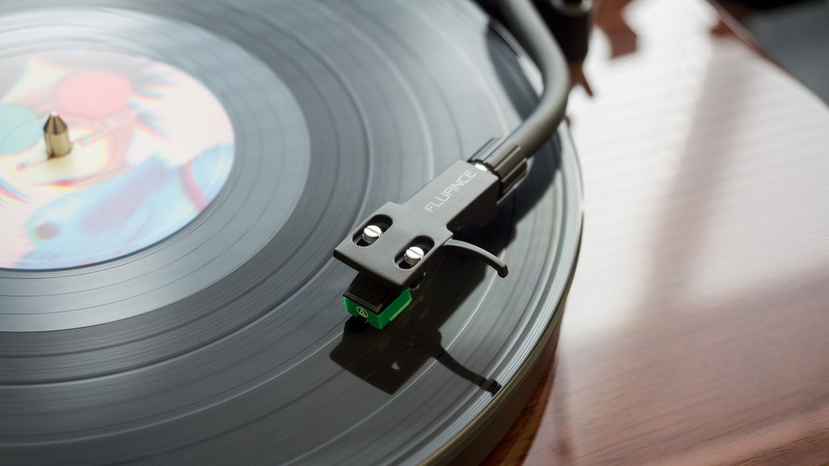

The model is Fluance RT81
And here is the image of he headshell
As the stylus needle snapped on my ATN95E cartridge, I am looking for a replacement. I came across ATVM95E cartridge on Hifimart and wanted to find out if this would be compatible with the headshell that came with my turntable.
The AT-VM95E can be fitted onto this standard 1/2" mount headshell

Sisyphus is right. The tone arm is aluminium and RT81 is a fairly decent turntable from the Canadian company, possibly sourced from Hanpin. Having said that, ATVM 95E or it’s more sophisticated stylus profile versions like Elleptical Nude or Microline may be even better. Other carts easily available in India ie Ortofon series,may give an upgrade, but then again sound is an individual preference. AT VM95E is a safe bet. Incidentally a Technics DD TT has its conical version as OE.
