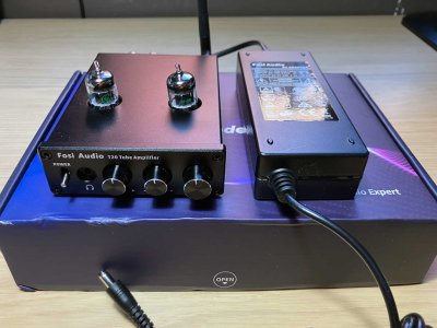

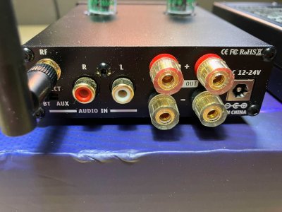

This is a Bluetooth and RCA line-in desktop product, roughly the size of a passport. It is powered by a separate adapter. While it does not feature optical, coaxial, or USB connections, it is designed to stream music from your phone via Bluetooth. For streaming via Google Chromecast or connecting a CD player, you can use the RCA line-in at the back of the amplifier. There is a switch at the rear to select either Bluetooth or the RCA inputs. During testing, streaming was always uninterrupted, with stable performance as if it were connected by a cable.
Build Quality​
The amplifier is compact and well-built, with a solid finish. It has an attractive metal casing, and the front features sturdy, high-quality metal knobs and switches. The amplifier measures 9.9 cm in width, 6 cm in height, and 18 cm in depth, including the power connector and Bluetooth antenna at the back. The height includes the two small tubes mounted on top.
The supplied tubes are of the 5654 type from General Electric, and you need to install them by pressing them into the sockets on top. According to Fosi Audio, the tubes can be replaced with JAN 5654W, 6K4, 6J1, GE5654, 6AK5, 6ж1П, 6BC5, 403A/B, EF40, or EF95. Fosi sells replacement tubes for €20 should you wish to upgrade. A blue LED lights up beneath the valves when the amplifier is turned on.

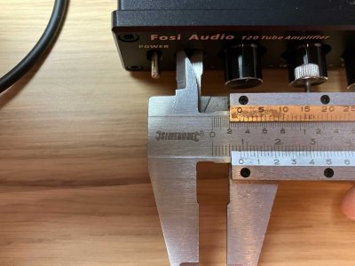

On the front, there is a 3.5mm jack socket, which is positioned about 3mm deeper into the front panel and accommodates a jack plug up to 9.5mm thick at its widest. In addition to the on/off button and volume knob, there are two rotary knobs for treble and bass control.
However, if your 3.5mm plug features a plastic connector that is wider near the metal connector, it may not fit properly. This was the case with my Grado SR80 headphones, as well as the newer SR80x, both of which have connectors measuring 11mm wide at the plastic part. I ordered a "dual female audio cable Y splitter 3,5mm" for €1,60 on Aliexpress to solve this problem.

In addition to Bluetooth streaming, there is a stereo RCA line input at the back. Audio output is secured by either the 3.5mm jack plug or the small speaker connectors at the rear. If your speaker wire is 2.0mm² or thinner, or you use banana plugs, you can connect passive (bookshelf) speakers to the terminals. The amplifier can deliver 50 watts RMS with 4-ohm speakers. No software installation is required on your phone or laptop. When powered on, the amplifier will automatically connect to BT HIFI AUDIO, streaming all audio directly to the amplifier. The T20 can handle hi-resolution audio files from services such as Spotify, Tidal, Qobuz, Deezer, and others.

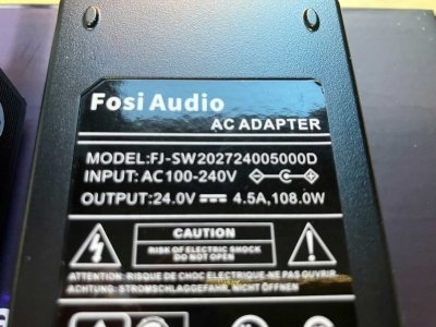

The supplied adapter has a cable length of around 2 metres, so you don’t need to be close to a mains outlet.

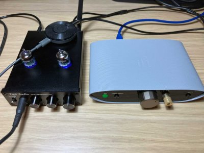

To test the sound quality, I used a pair of Audio Technica ATH-TAD500 headphones from a friend. These headphones are sensitive and easy to drive, similar in nature and quality to the Grado SR80 I own. Having used the amplifier for two weeks, my phone and the amplifier now connect via Bluetooth as soon as the amp is powered on. Normally, I listen to the iFi Zen Dac Air, connected to my laptop via USB. The iFi is a headphone amplifier in a similar price range. When the T20 is not receiving an audio signal, it is completely silent, with no background noise.
The Fosi Audio T20 clearly outperforms the internal DAC and amplifier in my Lenovo laptop, sounding more detailed, clearer, with a slightly warmer midrange, deeper bass, and better instrument separation and timbre. Listening directly through my laptop is unpleasant, especially if you’re used to a good external DAC/headphone amplifier.
When comparing it to the iFi Zen Dac Air, which is a DAC/headphone amplifier in a similar price range, the sound quality is comparable. Listening to Saint-Saëns' Le Carnaval des Animaux, I am impressed by the dynamics and its ability to reproduce the power of the piano and other instruments. The music seems more dynamic than when listened to via the iFi Zen Dac Air, and the instruments are more defined and precise, with a bit more clarity. Both amplifiers have a touch of warmth, but the Fosi Audio has a more pronounced midrange and a forward-sounding character, with bass that reaches deeper. While the bass isn't overwhelming compared to the iFi, it seems to handle lower tones with greater depth. Violins and high piano notes are precise, without being sharp or unpleasant. The overall presentation is natural and engaging.
When listening to the medieval classical La Folia de la Spagna, followed by Dementia Preacox Angelorum, the difference between the iFi and the Fosi becomes clear. The Fosi offers more power, a slightly more pronounced midrange, and enhanced highs and deep bass, making the presentation more energetic. The iFi, on the other hand, sounds more harmonious and less forward. The Fosi also delivers more detail without excessive treble, giving a sense of precision in the music.
Both amplifiers are excellent, making listening to quality headphones a real pleasure. It’s noteworthy that I never felt the sound quality was diminished when streaming audio over Bluetooth. To test this, I connected the Google Chromecast Audio, a small DAC, to the RCA line-in at the back. The Chromecast Audio provided a slightly smoother, less grainy sound, particularly in the higher frequencies, compared to Bluetooth streaming. However, the differences were minimal and not distracting. Streaming via Bluetooth is highly convenient, and for higher sound quality, you could pair the amplifier with higher-end headphones, such as those from Audeze.
