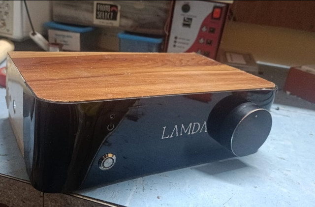

The amplifier chassis, a testament to both function and form, eschewed the typical boxy aesthetic. Instead, it embraced clean lines and minimalist design, exuding an air of
understated elegance.
The chassis itself was crafted from an Acrylic piece bent with heat gun , its to surface radiating a warm oak tone. The front panel, devoid of unnecessary ornamentation, featured only the essential controls – a volume knob with minimalist black hue and outer polish and a power button that subtly illuminated with a soft, ambient light.
This harmonious blend of form and function resulted in an amplifier that was not merely a piece of electronics, but a sculptural object that seamlessly integrated into any living space, elevating the listening experience to an art form.
Cost of the unit in 800-900₹ range without amp circuits
It looks great.
I have tried acrylic curved corner using heat gun multiple times but i was not able to get the result.
It's easy.. You need to
1) mark three lines per coner.. Slow heat
2) if you can do it at once
3) tip use curved object for perfect shape.. Wear heat proof gloves.. To do it
