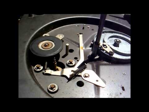

haven't tried to open it yet but would you know what spins the platter? motor or belt or both? are the mechanics of rc210 very different than the modern TTs?
thanks! @reubensm
will see about the DIY and sending pictures Im not poor at DIY that's all I can say but the spare parts is a issue
Its with a local sardar ji repair guy right now for 2 months. He's a very skilled guy and said he can try to repair but also said the spare parts if needed would be a problem as its an antique now
so still have hopes...will check soon with him about the status
The RC210 (RC stands for Record Changer) does not have a belt. The motor drives an intermediate rubber wheel called the idler which in turn engages the inner of the platter side and turns it. The platter in turn, engages the spindle assembly and other mechanicals which gets the auto-changer part to run. Hence the condition of the rubber idler wheel is key to the turntable's functionality. Here is a picture of a similar idler wheel and motor pulley from a record changer (this is not the RC210, but looks similar):
The mechanicals of changers are more complex when compared to standard record players and turntables. They work on a maze of levers and cogged wheels :)
