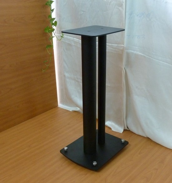

Plan for a stand that puts the tweeter at ear level when seated.
I have an SF stand, don't know the model. It is about 24" height.
The column (single) is about 22"

As @Raghu has pointed out it’s good to plan the height of your stand. Calculating from
1. Your ear level at your listening position.
2. Height of the centre of the tweeter from the base. (Of your bookshelf speaker)
And then calculate the required height of the stand (spikes to top plate) so that the centre of the tweeter and your ear are at same level.
@premoddev has mentioned that Ali (very helpful) can customise (hopefully the height). I bought the (standard height) Monitor Gold from SF a few years ago and I did not think of this. I wish the stands were a bit shorter by 3”. I am tilting them (back to front) a bit to compensate. But …meh
A thought: if Ali is reading this: include some guidance on this for future buyers.

I would recommend going for a 'proper' speaker stand which is stable, rests your speaker at appropriate height (Tweeter being at your ear level) and most importantly, isolates your speaker from the ground and vibrations. The last part is critical to getting the best performance out of your speakers.
As mentioned above in a post, speaker stand also lets you adjust the height a bit and can compensate for uneven floor.
Also check with your speaker manufacturer for the recommended height of the stand.
I have a Joseph Audio Pulsar 2 and as per the manufacturer, any stand longer than 24inch will have negative impact on the bass performance.

I would not go with either of the pepprfry stands.
The first one (Jeffereson) will probably not anchor down properly. Center of gravity issue.
The second one has a box underneath. Bass will become boomy.
Would suggest SF as a ready made solution, if budget permits.
If getting stands custom made the options are:
1. Metal
Top plate 6mm thickness; LxB = 1/2" less than the speaker footprint
Bottom plate 6mm thickness; LxB can be a bit larger than top plate
Column 3 in hollow (sand fill capable)
Spikes (3 or 4) for leveling; 3 is easier for quick leveling (like tripod)
2. Wood (heavy woods like honne, walnut, wenge, cherry, etc)
Top plank 12-18 mm thickness; LxB = 1/2" less than the speaker footprint
Bottom plank 12-18 mm thickness; LxB can be a bit larger than top plank
Columns min 3 in triangle formation; at least 2x2 inch
Spikes 3; one next to each column
You may combine wood and metal, by choosing top and bottom to be wood.
Use spacers/gel pads between top plate and speaker bottom to avoid scratches.

Thank you everyone for your inputs. Based on the advice I will go ahead with the proper speaker stands
:D I just calculated the height, my listening height is around 46-48 inch from sitting position, will calculate the height of stand needed for Q3020i
Oh. You don't have the speakers yet? Then wait till it comes home.
Use a pair of identical stools (those plastic ones that are always around)
Stack some books and try various height settings with placement options.
