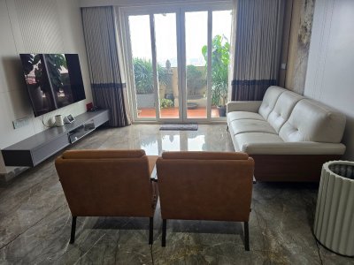

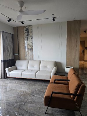

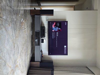

1. Yes have a tall glass crockery cabinet and glass sliding doors to the balcony.
2. The seating position is close to the back wall, the distance to the speakers will be 13ft. The distance between the speakers will be around 10ft. Ceiling height is 9.5ft.
3. The right side speakers will have a curtain right next to it, while the left speaker will have an open space.
4. I will be able to sit in the middle of both speakers and I can potentially add a carpet as well.
5. Added some pics for your reference.

I think R3 meta works the best in this space here. The room has lot of reflective surfaces around, so you might need to use some EQ to correct the sound reaching your spot. You can do that to some extent on focals however then your sweet spot for the good tonality is going to be very limited to the middle seat. Again the ceiling is not very tall and floor is very much reflective, again works in favour for a speaker with better vertical directivity.Hi @Passive_audio_enthusiast, thank you for your questions, made me think more.. let me try and answer them below.
