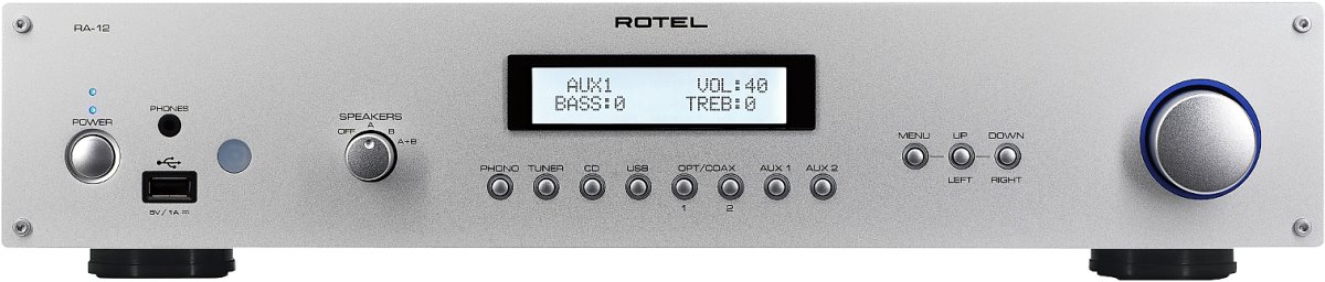

Rotel RA 12
Super matching IMHO fast,very good low bass,detailed...same concern company
You can use Bluetooth also...
thanks Maxprocrj, i agree about the RA12, wonder whats the street price in Mumbai? I asked a dealer he said (86K INR). I did not bargain?

thanks aashish351 for the advise, will steer clear of the CA651. i think its between the NAD 356DAC and the RA12. I am favoring the later but...it will really stretch my budget
685 S2 is nutral to warm sounding speaker....not at all bright....
So NAD boomy sound musnt matchs well with it...
Budget....yea....
Wait if needed...but you would not repent or shall look out for upgrade for sure in near future its worth.....
