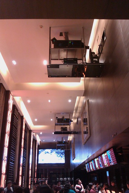

Sriee, even I become curious when I go to a new theatre about the projection and the sound system installed but sadly very few theatre display information about the projection and sound system installed in their theatre. As for Escape cinemas they started off with 2K Projectors from Christie and now I think they have upgraded them to 4K or might have got new 4K Barco projectors connected to QUBE 4K servers. For sound processing they use QSC DCP 300 processors, it has some advanced featured which is not found in older Dolby and DTS models. For one of their screen they recently installed a Dolby CP850 sound processor for Dolby Atmos sound system. They use 4-way front speakers from QSC for all their screens, surrounds are also QSC speakers and they are powered by QSC amplifiers.
The unique feature of this theatre is that they do not have projection rooms for their projectors and I think you would have noticed this if you spotted the projectors suspended from the ceiling outside the halls. Projectors are controlled from a central location with an automated system which handles playback of content based on the playlist and show times set by the theatre. The advantage of this design is that it saves space and it makes it easy to control and monitor all the systems from a central location.
Here is a picture of the theatre's projectors for people who have not been to this theatre -
Escape Cinemas by ashwin kumar, on Flickr
