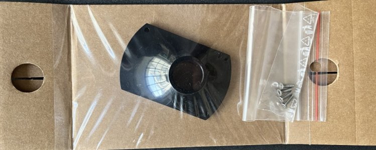

I already had a SME armboard for the TT, hence purchased the SME adapter for 9W1 arm. The dealer has sent attached picture (9W1 SME adapter) and says the PTS distance will be true once it is mounted on the SME armboard / TT.
I have however seen pictures of SME adapters on the internet with groves on the slides of adapter which I assume is to adjust the PTS as per requirement on different TTs as shown in another attachment.
If I go as per the dealer it means there is a standard distance in all TTs which accept a 9" arms between the spindle and hole for the arm board?
Please can someone shed light and correct my understanding.
Each arm has a pivot-to-spindle distance which may or may not match that of another 9" arm. Likewise, with overhang. The difference is in millimetres. The advantage with the SME base is that you can move the adapter back and forth till you get the tracking angle perfect using the standard protectors.
