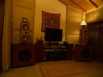

Some background on my DIY speakers and setup which was quite complex. The MTMs are a combination of Peerless drivers with a Vifa tweeter and a crossover that took about 2 years to get where I was satisfied with the sound and were driven through the Creek pre connected to a B&K power amp. For the lows I originally had two passive 15" woofers driven by a separate amp through another pre !!! A very complicated system but sounded great with the room treatment I had done.
I shifted house so had to compromise and ditch my 15" subs and simplify my system which is why I zeroed in on the DX9.
Attaching a pic of my old setup.

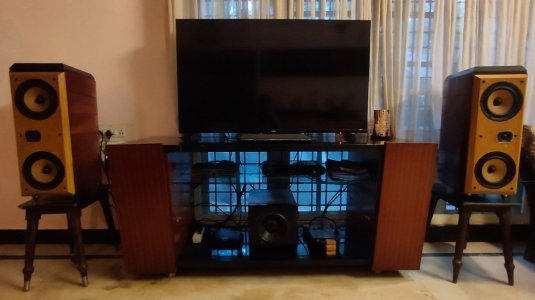

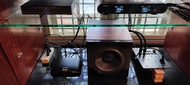

To follow up on the Topping DX9, I got a set of XLR cables to connect to the plate amp and though it did increase the gain it's still a compromise. The XLR's do send a stronger signal by which keeping the volume at max on the plate amp allowed me to drop the crossover frequency from 95Hz to 75Hz and tightened up the lower base and lifted a slight veil on the lower mid's. A proper line out would have allowed me the option of dropping the crossover even lower, but It's a compromise I'm willing to live with since it sounds good even with limitations of the room.
The other thing that I'm noticing is the noise floor is dramatically lower and the silent passages stand out. Sorry, still haven't tried true lossless/HD tracks as I'm having way too much fun listening to tracks on Spotify.
Posting a couple of snaps of the current setup.

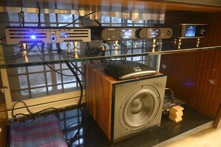

Sorry, I still haven't had the time and inclination to experiment with the coaxial and optical outputs, just thoroughly enjoying what I'm hearing for now. What I have done is added a really good spike protector in addition to the servo stabilizer which has reduced the 'noise' and cleaned up the sound. I always felt streaming from a laptop wasn't the best option so I picked up a Wiim Ultra from a fellow member (thanks rajudhs) which I am using as a dedicated streamer.
The setup is now is USB out from the Wiim Ultra to the SMSL and I2S out to the Topping. I have a couple of ferrite rings on the cables for good measure. The Wiim Ultra as a streamer is just brilliant to use and it's down to the Wiim Home App which is one of the easiest to navigate through and has tons of options to tweak and change sound quality. I still haven't felt the need to play around with the EQ options, 10 band equalizer or the parametric EQ that can be individually configured for left and right channels. I did try and play around with the streaming resolution 44.1 to 192 khz but found that though the 192 setting had a lot more detailed it didn't sound natural so have left streaming at native resolution (44.1 with Spotify) but 32 bit.
Now coming to the main point, how does it sound compared to streaming through a laptop. No comparison, the sound is fuller with more body and I have more snap and detail from the leading and trailing edges of individual instruments. Image height and width have gone up substantially, but not depth, and I might have to try and tweak my speaker position to get the best out of the system. The output voltage from the Wiim (fixed out) must be higher than the laptop because at the same volume the sound is louder.
When the daughter says 'wow' you know you've hit a home run.
