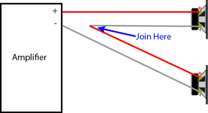

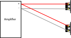

The combined impedance will reduce. Two 8 ohms in parallel makes it 4 ohms. Two four ohms will become 2 ohms. This is just the DC resistance. Putting them in series will increase the impedance but you will have to crank up the volume. Series is a much safer option.
assuming the speakers are identical... for 8 ohms follow image (1) and for lower go with (2)
