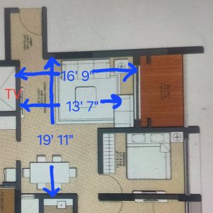

Recently bought a new house and planning to get interiors done along with wiring. I can't have dedicated HT room, so turning living room into one. I've attached room dimensions and would love some feedback.
