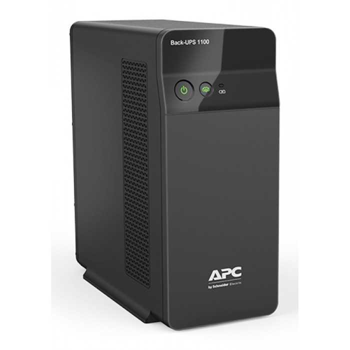

Currently, I am using an APC 1100 ups to protect my tv and ps4 pro.
Now adding this projector and AV receiver I want to know what will be a good power protection solution for me to protect my devices. I have gone through many threads but I was completely overwhelmed trying to understand it and I don't want to spend too much on protecting it (10k) .
Can you please tell me what will be the solution for me - Please give two options , minimum and ideal. Can I just buy another APC 1100 ups to protect these two items (along with the speakers it powers)?

So I got a stabilizer and another apc ups 1100
Am going to connect the projector to the ups.
For my avr and subwoofer i have a question:
Should i connect
main - - >stabilizer - - >subwoofer, avr
Or
Main - - > ups (older one) stabilizer - - >subwoofer, avr
In my apartment there are frequent power cycles.. Whenever the power cycles it takes 30-180 seconds for the generator to come up.. This happens on average 5 times a day..
Buy another one of these (considering your budget & backup requirement) and hook your Projector/AVR to it and I believe you should be good.
Should i connect
Or
Main - - > ups - - >subwoofer, Avr (UPS will automatically switch to Battery if the Mains voltage falls below the threshold, you may not need the Stabilizer). Non-Sinewave UPS and Stabilizer is not a good combination.
:( I already purchased the stabilizer based on multiple threads here where people mentioned that instead of ups use only a stabilizer for the subwoofer and avr...Should I try and return the stabilizer or use it along with the ups?
Well, if you don't suffer from power fluctuation then you probably don't have a use case for Stabilizer. Generally in Bangalore, a good UPS is more than sufficient.
